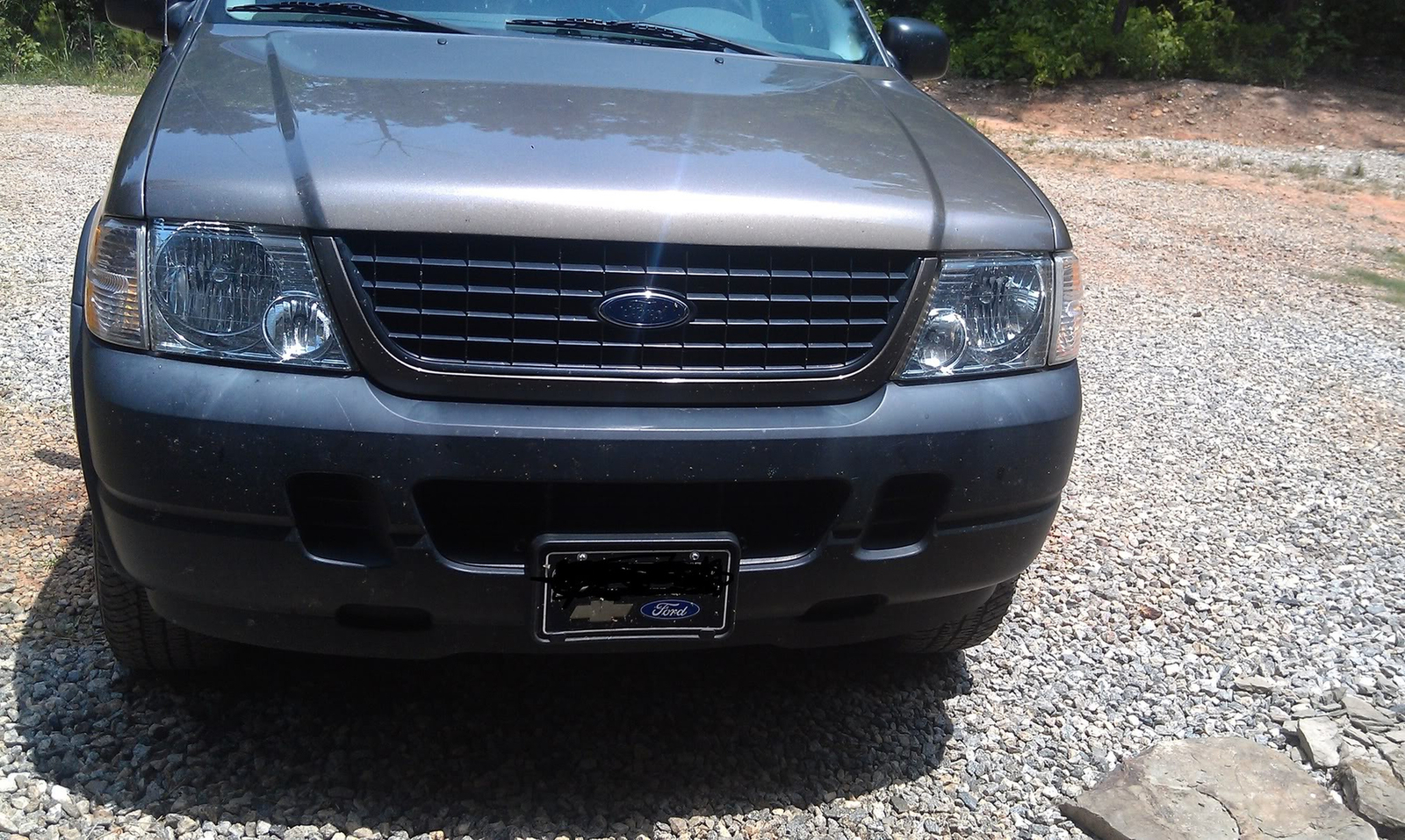

But i want to paint the harness background black instead of silver/chrome like it is, here pic of my front

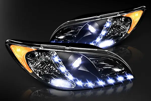

theres these but there 182$
Im trying to find somethign with black background that will fit my 05 explorer.
Is there paint i can use to paint my stock ones??? I dont want to ghost the lens jus the inside.
yeah, any rattle can paint.. Krylon will work wonders. Bake off the lens in the oven.
i would use duplicolor, ive had best luck with it. scuff the chrome really good. spray and some adhesion promoter. and paint.
here is a set that we did on my friends truck. (duplicolor)
and the set on my ranger (actual automotive paint - not rattle can)
and yes those oracle rings are JUST rings, you have to install them in the housing or take them some where to install em.
but if u attempt to open ur lights, it really not hard to open just bake em for like 10 min.make sure all screws and clamps are out first and it should peel right open.
the hardest part is sealing it. make sure u have clamps that will hold it tight, and i would do one at a time, letting each seal and cure for 24 hrs.
