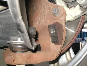

Sway bar end links and frame bushings are common failures but end links usually clunk when broken and frame bushings generally squeak when dry or worn. While under there check to see if the steering stops are dry. Usually makes a loud metal to metal grinding sound when the wheel is turned to full lock and moving slowly over bumps. There's a round nub
on each LCA and a crescent shaped stop on the knuckle that should be greased to prevent binding. Pic below is from a 4WD ST but yours should be similar. BTW, excellent audio from your clip although I'm still baffled what the noise is. GL
