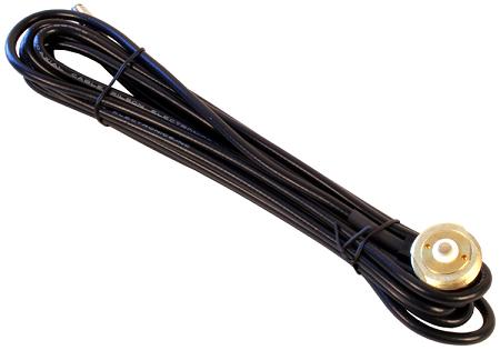

I install these in all the sheriff's and fire rescue
antenna
tool cuts perfect hole for attenna

this is the tool I use to cut the hole, Fyi make sure you drill a flat piece of sheet metal and that you do not drill in to the roof supports, you can pry down the headliner to look before you drill and use a snake to fish wire , then just run the wire down the inside of plastic pillar. I run the radio on a relay so it is switched, I put the relay under the hood nexted to the fuse panel, run one hot and ground from the battery, the take fuse #25 I believe for you switched, that is an safe accessory to tap into. from there you can run power into the truck, there are rubber gromets on the driver side firewall,
