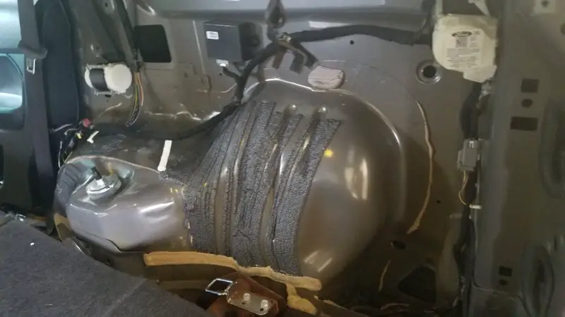

Can any tell me if the white bondo is factory or my vehicle been in a wreck? Does anyone else have this in their vehicle. It is on both driver and passenger side.
8hO2FMO
Looks like seam sealer applied to a joint after the body was painted to me, appears factory judging from the photos.
body seam sealer, not bondo
your good!
Agreed. Totally normal.
That was my thought as well.

Every car uses seam sealer. It’s not a problem, or shortcoming. It’s nothing like “bondo” ( which is nothing but a brand, and it’s color is irrelevant, it’s body filler which this ISNT) Body filler is porous, and absorbs water. Seam sealer is more on par with a silicon or urethane and is not water absorbing.

Well I found, where the noise is coming from. I removed the left trim panel, and seems like the rear left interior quarter panel is rattle against the ac system.
Well I found, where the noise is coming from. I removed the left trim panel, and seems like the rear left interior quarter panel rattle against the ac system. There is also play for the seat belt anchor in the D-Pillar. When driving the anchor wiggles against the metal. The bolt in the D-Pillar is tight, but there is to much play to make a metal to metal noise while driving.
