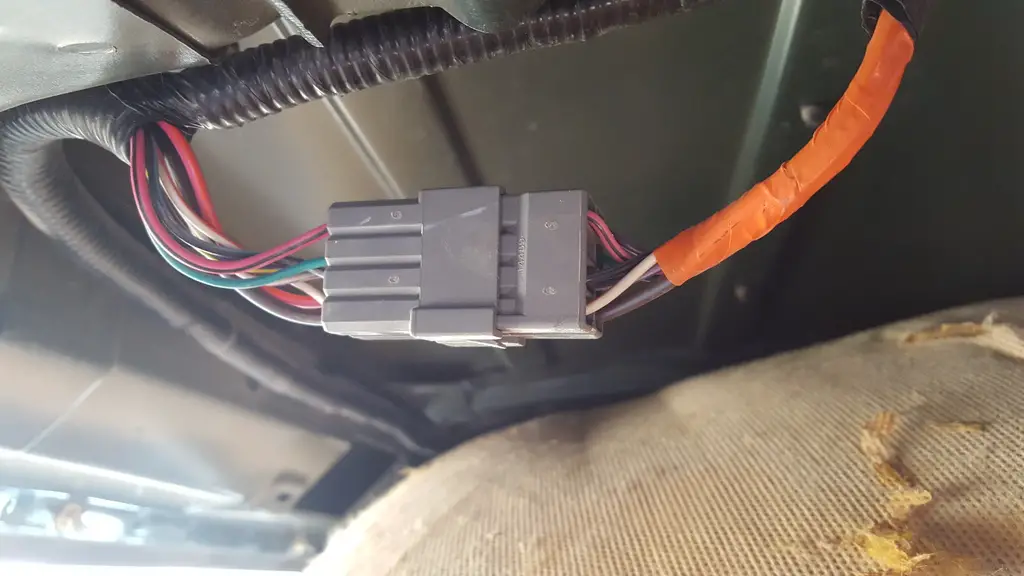

Here's a pic of the vehicle's square connector fastened to the '98 hatch connector and the obvious wire differences:
Is it safe to repin the different wires to their corresponding same-color wires on the body side connector? I hate to just guess and have electrical problems afterward.:eek:

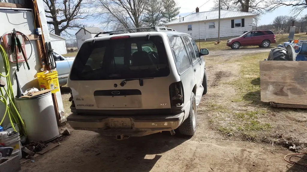

Here's a pic of the installed hatch but before I put the tails on. When I snagged the hatch from the JY, I had intended to get the matching bumper, but they were all beat up so I passed, as mine is perfect. I will probably just get a vanity plate and put on it..something that says "Powered by 5.0" or something similar. :D

Repinned the wires to their proper locations, things work as they should with the exception of the license plate lights on the hatch. I didn't have time to run new wires (yet).
The lock for the hatch is iffy...locks at times, others, not so well.
At least now I'm able to lock the hatch and glass, and my third brake light works.
It's a good day. :)
I went through all that when I swapped the hatch on my 97 sport with a latter one, had to pull the tag light wires from the bumper back up into the driver side pillar with some more wire added , ran it up above the headliner down through the rubber wiring boot , can't remember how I tied it in but I remember it looked factory when I was done so I probably used some sort of factory connection , it was a pain but a great upgrade
