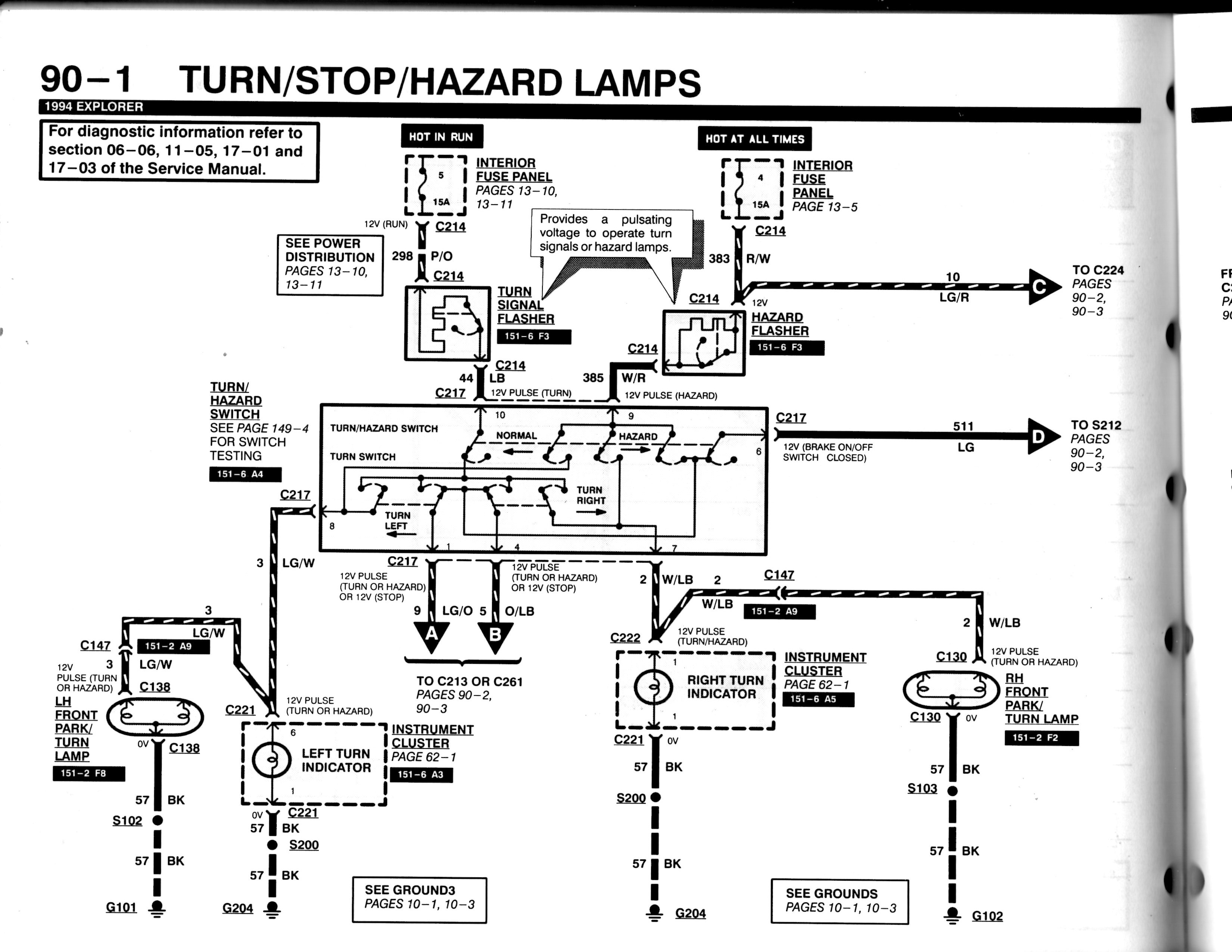

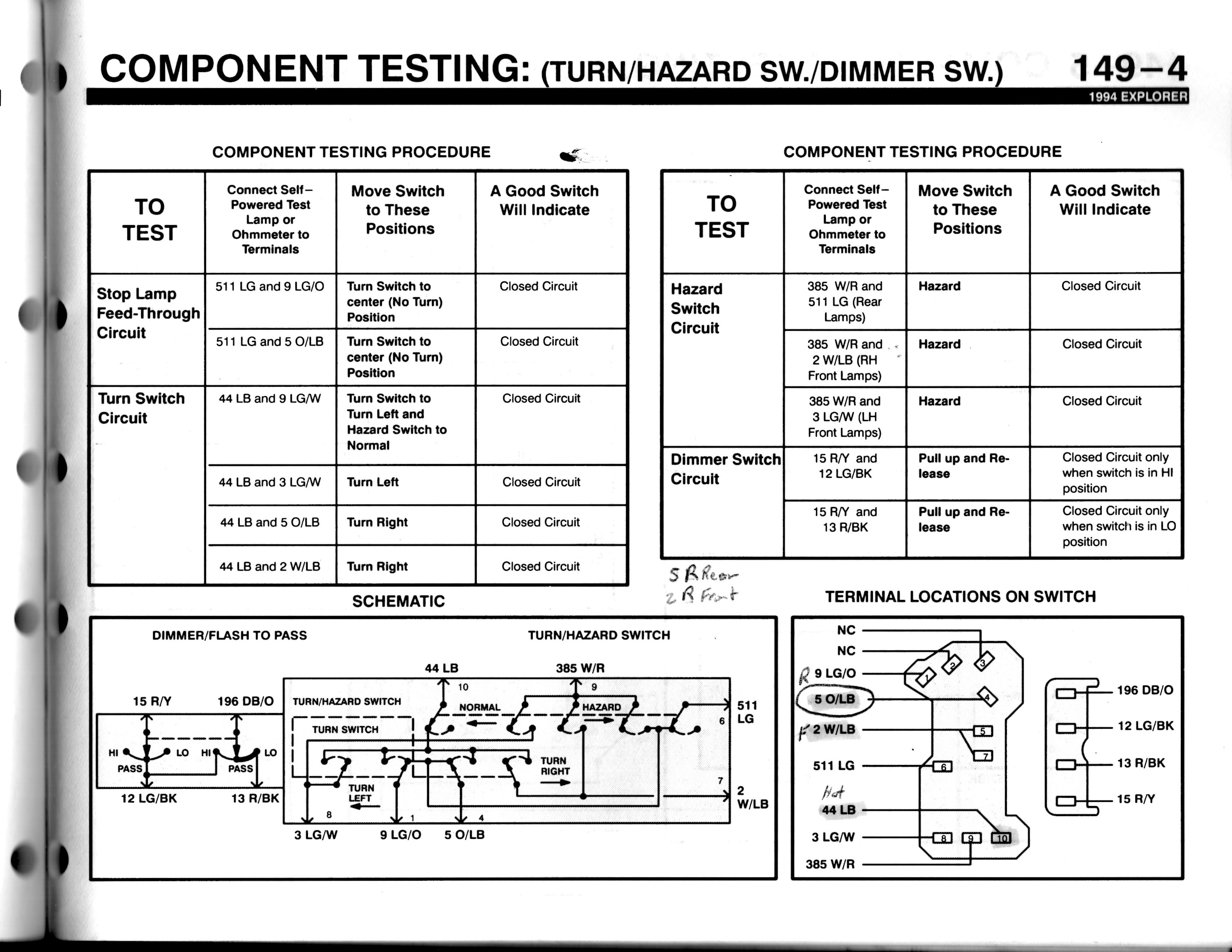

Hazards stay on constantly on my 93 XL replaced all bulbs checked fuse replaced both flashers? checked wiring to an extent without removing dash. Any suggestions? BOO switch works (goes to 0 ohms when depressed)
