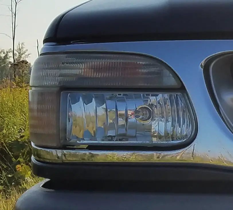

These are clear aftermarket housings just in a factory style. They have no light dispersion.
Showing a picture of a vehicle and making a claim, is not a specific product claiming to be designed for LED drop-ins, and as I already mentioned, it is literally impossible for universal compatibility because it depends on the exact placement, #, and beam angle of every LED on the retrofit.
Are those even LED drop-ins pictured? They look more warm colored like incandescent and yet, not showing the beam at night when it's dark, with a beam pattern on a wall showing a contrast between incan and LED.
If you just get some random aftermarket housing designed for stock incan bulbs, it will not have the right beam pattern for LED drop ins but even if it did, there is still the increased amount of light and cold color temperature, that isn't necessary for LEDs, but everyone is producing the cold color temp LEDs for misguided reasons.
The only way to have the correct beam pattern is a housing designed for a specific LED bulb/array, like found on vehicles with factory LED headlights which do not use drop in retrofit style bulbs.
