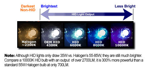

HID.
Does this tell me my headlights will be shinning bright blue.
I think it does and that may be the only thing I'm not to excited about.
:rolleyes:
Not necessarily, the color temperature of white varies from warm (yellowish) to cool (bluish).

Nope, your thinking of the ricer eBay HIDs that everyone gets that are like blue LEDs.
You will have 4300k which is CRISP white, no yellow halogen tint, etc.
Your cutoff might have the blue line but thats about it.

Bingo, the cutoff is where you'll notice that flicker of blue/purple. But overall they're a crisp white. Compared to halogen bulbs, they're much cooler so they may seem 'blue'.
