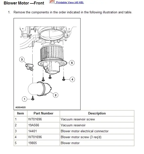

Mine seems like the motor speeds are 1, 2, 3, then 10. It is very noisy when set on hi, can't really have a conversation or listen to the radio comfortably, but it does cool the cabin down fast. You guys might have a blower motor that is unbalanced or maybe something has fallen down inside the housing. Take the blower motor out and check it out. It's easy on the Gen 3s, don't know about that 2006. Right up under the dash on the passenger side.
New fans are not expensive it if turns out to need to be replaced. Rockauto.com has them for $31.79 for the 2002.
rrgone,
Thanks so much for the help.
Some years ago I stored the truck in a friend garage for about 6 months, turns out they had a mouse problem. They had made a nest in the air filter compartment, I cleaned it out and they came back, cleaned again and thought they had gone for good. Turns out there were some leftover acorn hulls in the fan box, I cleaned them out and the fan is back to it's normal, albeit loud, #4 operation. Took about 10 minutes to do.
Now if I can only find a way to keep the damn mice out. I've heard that once they get in they keep coming back by the scent.I now have cinnamon sticks under my hood, been told they repel mice.
Thanks again for the help, especially the diagram.
