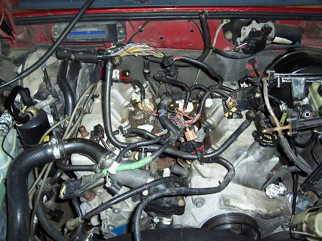

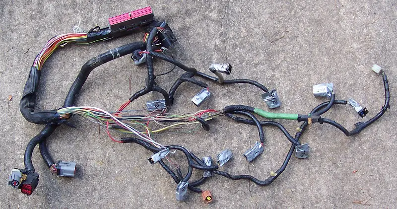

engine main wiring harness
I assume you meant SOHC V6 instead of SOHV V6.
The engine main wiring harness is located mostly on top of the engine.
It looks like this when removed.
Ignore that some of the wires have no looms as I was modifying mine when the photos were taken.
