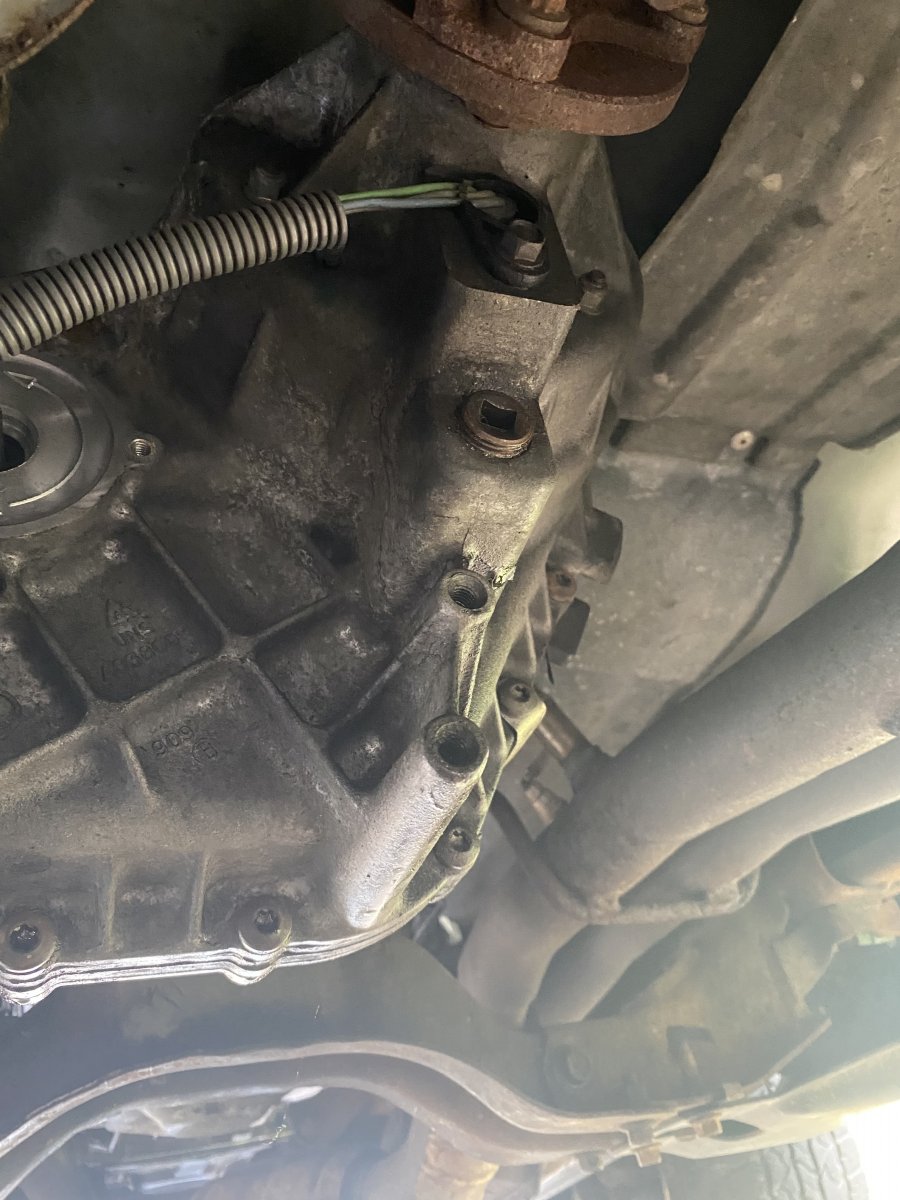

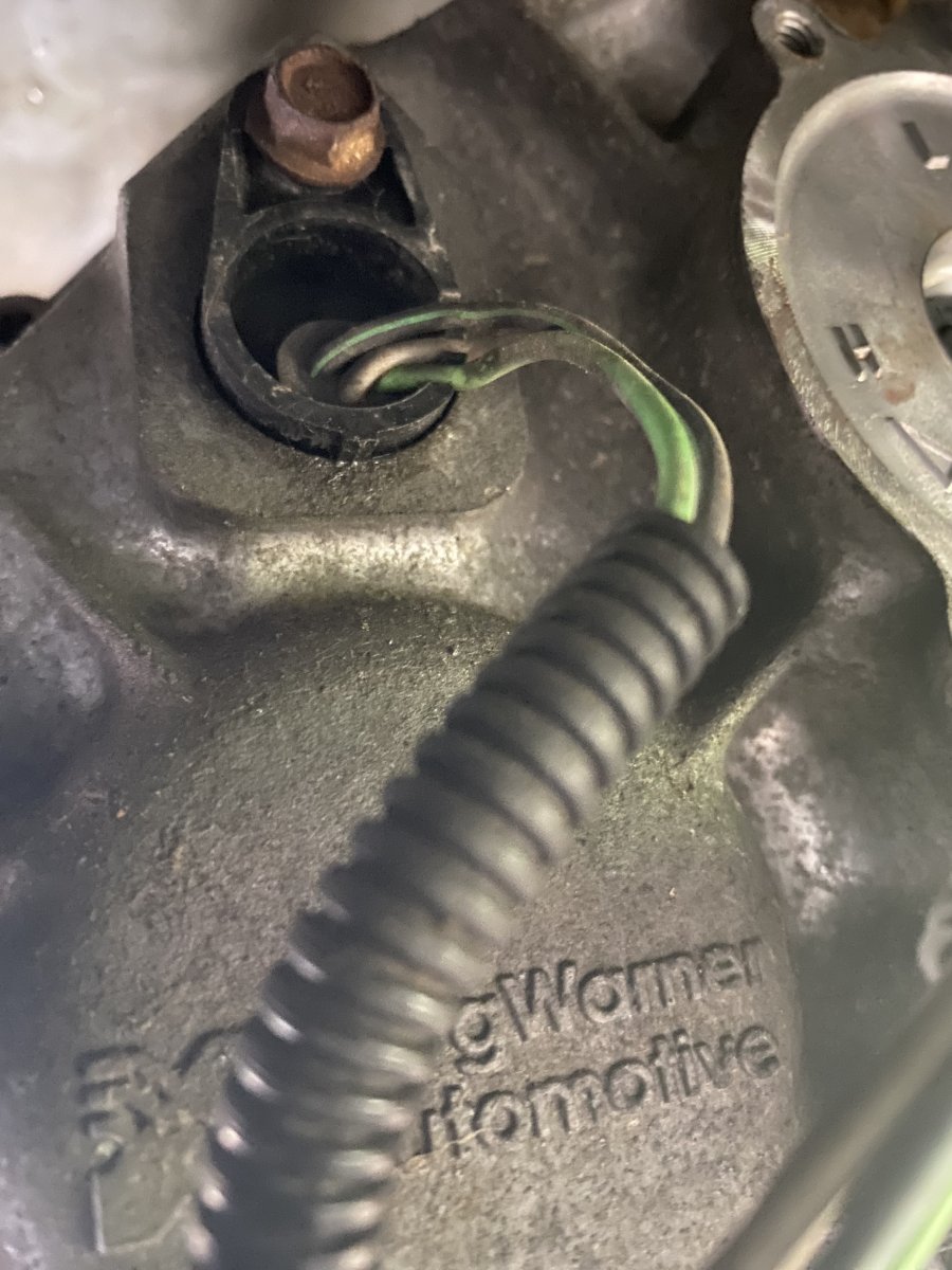

Those are the two speed sensors for the control trac awd portion of your t case

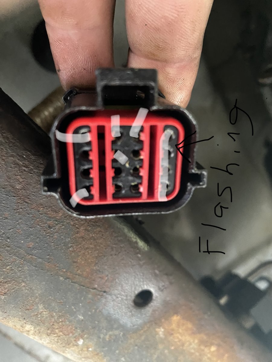

To use a new shift motor you will have to add the speed sensor pins into the shift motor connector
