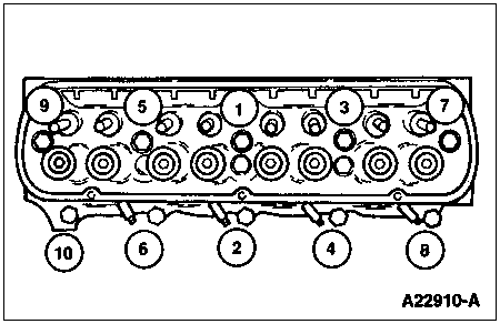

Head bolts
Tighten all bolts in sequence to 34-47 Nm (25-35 lb-ft).
Tighten all bolts in sequence to 61-75 Nm (45-55 lb-ft).
Turn all bolts in sequence an additional 85-95 degrees (1/4 turn).
