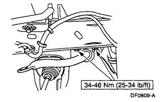

Here is the tightening specs for the front sway bar.

Front Stabilizer Bar Link Nuts (15-21 ft. lbs.)

where did you get the chart/pic with the tightening specs for the suspension? i'd like to find out about the tightening specs. when i replaced my shocks, i didn't know how tight to tighten the top of the shock on the front. i just tightened them all the way. should i loosen it up?
