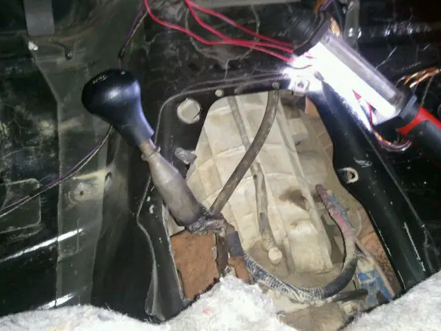

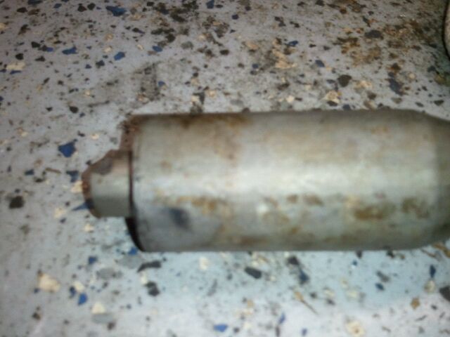

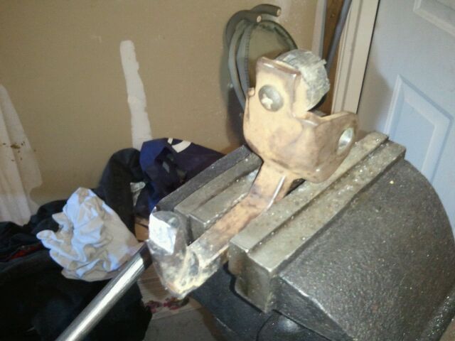

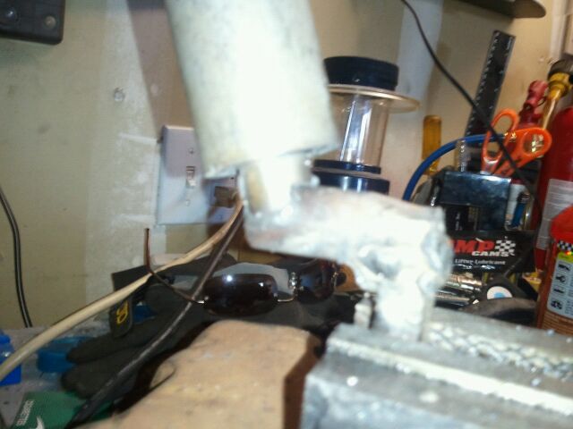

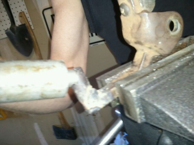

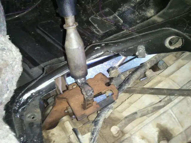

Here's a few teasers of the shifter modification
A few more, I hade to modify the trans tunnel a little as you can see in the last two pictures........Interior pictures to follow
