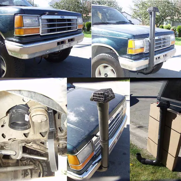

What you need is one of these...It's what I did after I hydrolocked last summer.
