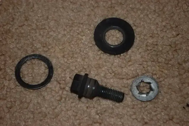

OK ya'll I did a little investigating into this issue this weekend.
Here is my old broken Pulley (Notice missing bearing balls)
AZ Replacement
4
So I was looking at my old one and noticed the little silver piece could come unscrewed and when you take it apart you get these parts.
Notice the bolt increases size near the head.
Now when I was freaking out and running all over in my mind I saw no reason why it would do that.
So once you get it apart you can see how it works out. So lesson learned instead of freaking chill out and think things through.
