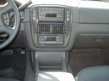

I prefer it to not be seen. I just took a look at mounting locations and the '02 so far looks like it was designed very well. Everything seems to be in a good location, easy to get to, and space left over. Changing the oil and filter will be a snap. I took some pictures of a possible mount points, but not sure if I can upload here or not.
aldive, just emailed two pics for you to post.

The 2nd picture shows the center console of my Explorer. I would like to mount a temp guage in the floor console just below the climate controls. I'm not sure what's behind that panel, but I guess I better remove it to find out before I order a gauge. Anyone know if theres a few inches of clearance behind that panel?
There is nothing behind the console on my 99; thats where I mounted my crossovers for the component speakers.
