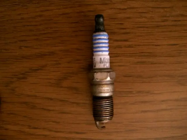

I'm relatively new to fixin my explorer and lately I've noticed signs that would lead me to replacing the plugs and wires..I pulled a few plugs and snapped a pic for some of the experts here to tell me if im looking at a good/bad spark plug and what too look for. Thanks!

Kinda hard to see, but appears to be a 'normal', worn plug to me. I see no evidence of water, fouling, oil, or detonation in the pic. Just some normal carbon build up. (Likely havent been changed in a long time.) Put some more in and drive it!

Thanks for the help, so i shouldnt bother changing them right now?
Looks like a nice normal plug to me too...
