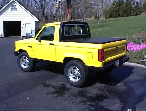

I'll be stripping a '91 for parts and would have a set for you but it probably would be late April until I do it. So if you're not in a hurry..
I'm pulling the drive train and springs for a BII so if need be I could torch out a small section of the frame to get the mount off.
that would be great but a "BII" isnt that a bronco II
are the rear leaf spring hangers the same? anouthe thing ware are you locatied
The parts truck I bought is a '91 Explorer. I'm going to pull the 4.0/A4LD, Dana 35, 8.8 rear and all four springs to put in my Bronco II. I'll sell any extra parts from the Explorer before it goes to the scrap yard. Like I said though it'll likely be towards the end of April before I can get you the mounts. I'm in PA but I would think shipping shouldn't be that bad for two mounts.
