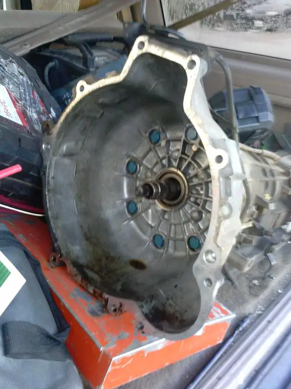

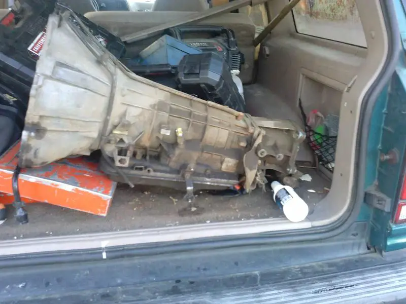

Got my new transmission some i lost the vote to just pull the tranny so my buddys just pulled the motor and trans which actually made it a lot easier. Iet was a whopping 90 bucks lol with fress fluid. So tomorrow its time to get mine out and this put in
Nice , Wish I could find them for that price and be easy to pull them , Good luck with the swap , And I'll keep an eye out on your threads !
Thanks i hope all goes well ill also post up as many pics as possible

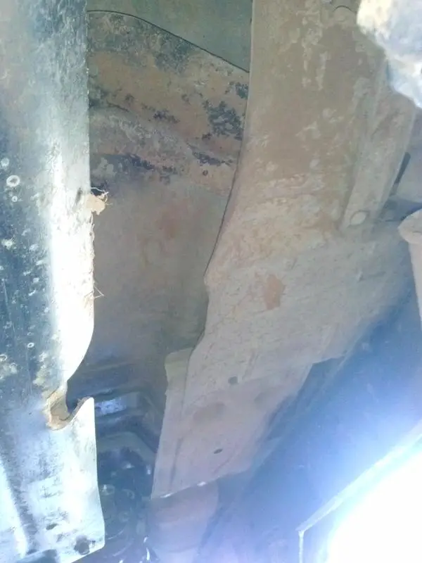

1. Driveshaft off took a 12 point and 13 mm
2.Exhaust out of the way
3.remove transfer case 13 mm 5 bolts also remove 2 connections and linkage
4. Remove starter 17mm bottom and 14 mm top set off to side and cooler lines with 5/8 and vacuum lines
5. tork converter bolts able to get after removing starter 4 bolts 13mm
6.remove kickdown linkage used door panel tool to remove and remove the 2-3 wire connections.
7. Bell housing bolts 6 13mm and 2 11/16 on top had to use swivel socket and extensions with air ratchet to not strip them also leave 2 bottoms barely in
8. Take trans mount off 4-5 3/4 bolts support trans take bottom bolts out and pull trans away. P.s. support motor with jack or it will drop.
9. Reverse procedure and install.
