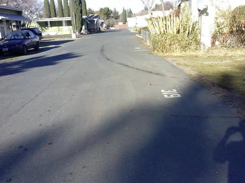

The trail of fluid to get an idea how bad it was leaking
Ouch , that looks to be a bad leak , I would guess its coming from the TC Bushing , It would take a really bad pan gasket or Servos to leak from there .
