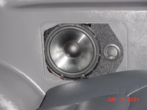

Well I've finished the install, and must say it sounds amazing. The woofers are mounted in the stock speaker locations. I had to make a half inch adapter for the front doors, and do a little trimming of the factory plastic mount for the rear doors. The tweeters are all flush mounted in the doors, I did have to cut the sheet metal behind the tweeters to fit them properly.

All then tweeters are flush mounted in the same place on each of the foor doors.
I had to cut the sheet metal of each door (upper left of picture) to clear tweeters, I also had to make a spacer to mount the woofer in the factory location for both front doors.
For the front door panels the crossovers are mounted under the armrest, I couldn't find a suitable location on the door it self. The rear doors have the crossover mounted directly to the sheet metal.
Another pic of the woofer.
I'm using 500x4 @ 4ohms amp to push both componet sets. It sounds amazing. I did have to up the gains on the subs so they weren't be over powered.
