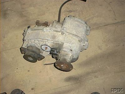

I am looking at a picking up a spare t-case just in case. I've got someone that has one for sell but he can't tell me if it's electric or manual. What is the difference in the part number for this. i.e. its a 1354 t-case but how do I know if its manual or electric. He sent me these numbers off a tag on the t-case:
>CO223
> 269973
> 1354-13
> F27A-5A
At least I know its a 1354, but the dash 13? What can anyone tell me about this transfer case from these groups?
here is the pic he sent me!
Can you ID this t-case

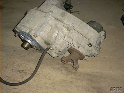

How about this one does it help anymore
Electric shift- take a look at the first picture the shift motor is missing, but it goes in the "clean" space with the bronze shaft thats showing.
Thanks all that was just the help I was looking for.
