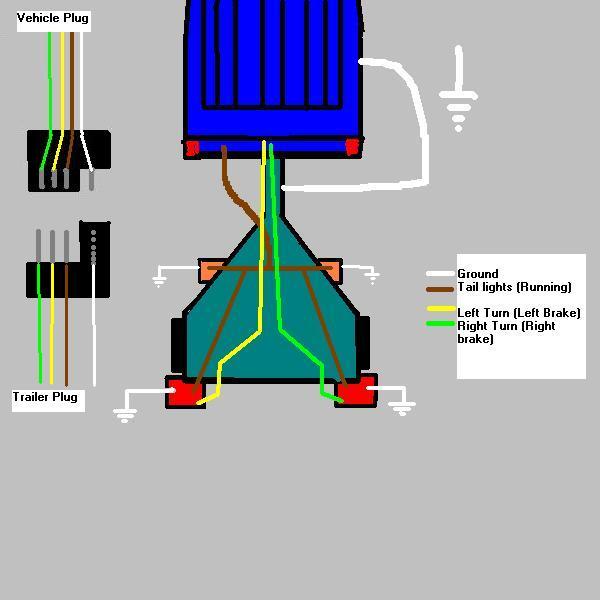

Use this to match the trailer wires up...make sure they are the same as this....U haul wires up trailers backwards...
Thanks for the pic, I'll double check the wiring, but even if some of the wiring was backwards, wouldn't some of the lights still work or come on at all? I mean nothing works period and I have tried running wires to different locations without any luck.
