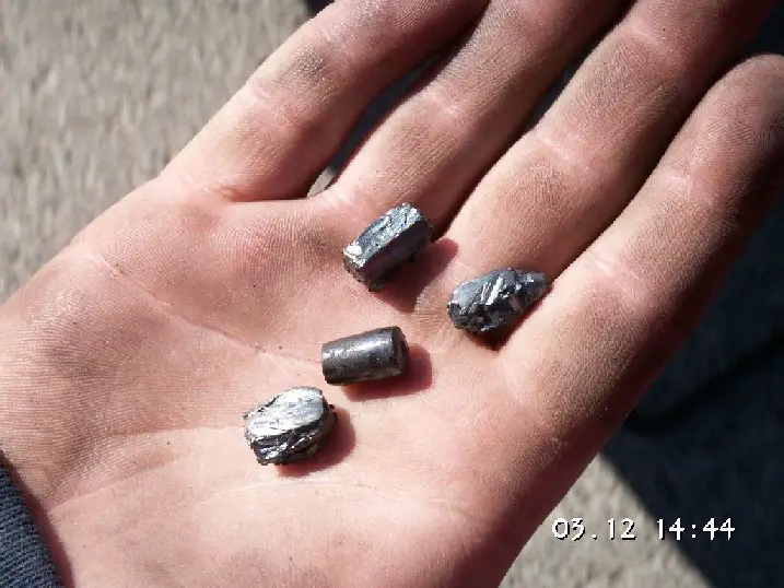

get it changed immediatly and dont drive it. this was goin on with chris's truck yesterday and he blew the bearings and we were stuck on the side of the oraod. his rotor moved too.
you see this happend yesterday.
