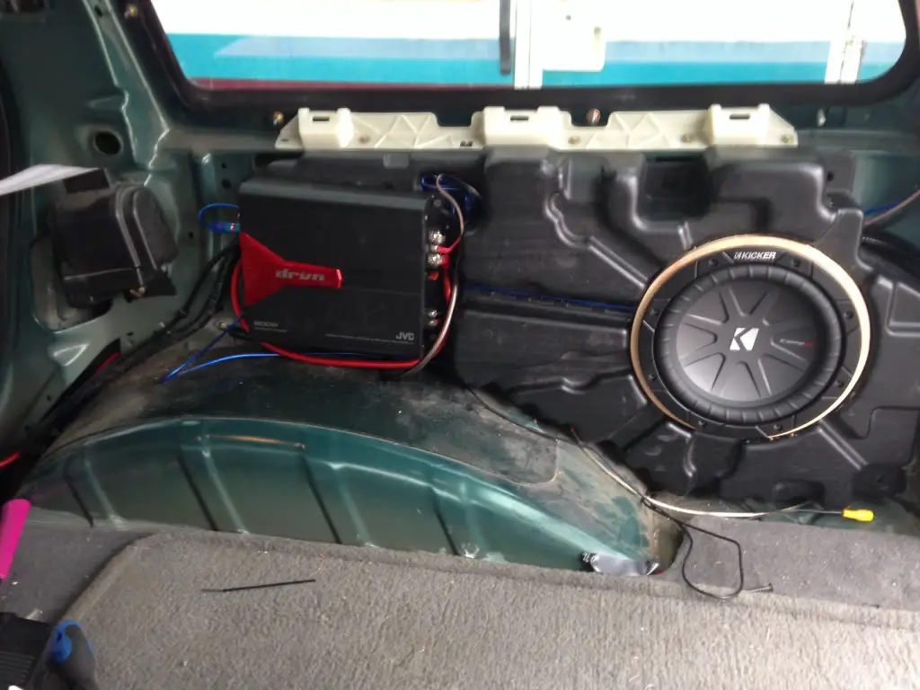

I don't know if you could do something like this in yours. It took a hell of a lot of work. Finding the parts, cutting, sealing @ making shims.
I highly recommend Kicker. But stay away from their yellow line (made for walmart)
RCA's run under the box to the carpet under rear seats and up front from there. Also have the. 4AWG power wire running the same way. The hardest was running the wires & delikit video cable through the tail gate hinge for the camera. Getting those clean,hidden & safe from pinching was a ***** ;-)
But yes for the short run from under the rear seat carpet to the amp I have them inside the door frame pillar.
