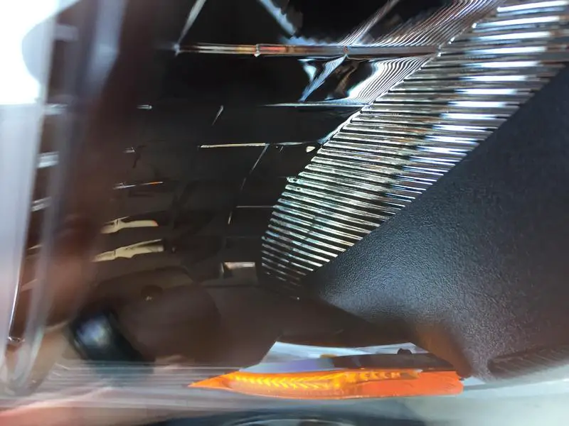

However, I do think the reason they're amazing is the new housing and how it's built to accommodate LEDs (LED bulb comes in from the side unlike the high beam bulb shown to the right. This is my passenger headlight)

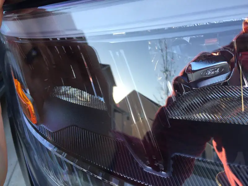

Here's another terrible view of the LED "reflector" or whatever it is.
The bottom is the far left, the uploader flipped my photo. The top is the right side of the passenger side headlight.
