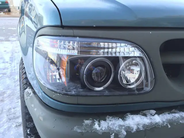

I have a set of aftermarket projectors in my Exploder, and although the build quality is a bit "ebay-ish", they are a big improvement over the stock lights. (...and yes, I did take the time to aim them properly).
led headlight bulb replacements, and a 30 inch light bar on the roof rack, and done,,,
Is this a custom headlight, or a retrofit? Looks like custom to me.
You can get a set here. Not sure I'd specifically recommend these specific ones, as the fitment is a bit crap, and it will take some swearing to install them.
