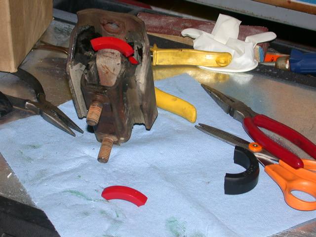

The vibration I chase is common to first gen X's. Many believe there is a design flaw between the drive train and the frame geometry. At a certian speed (not RPM dependant and it changes with tire size), the drive train sets up a harmonic vibration in the frame rails. It's like an unbalanced tire but feels like it's coming from the center of the vehicle.

Re balancing the tires is probably the cheapest thing to do first, then an alignment. The tranny mount for mine was less than $50 and I had the poly pieces laying around, but I spent a LOT of money on the other stuff first. I would recommend trying the tranny mount early in your quest.
