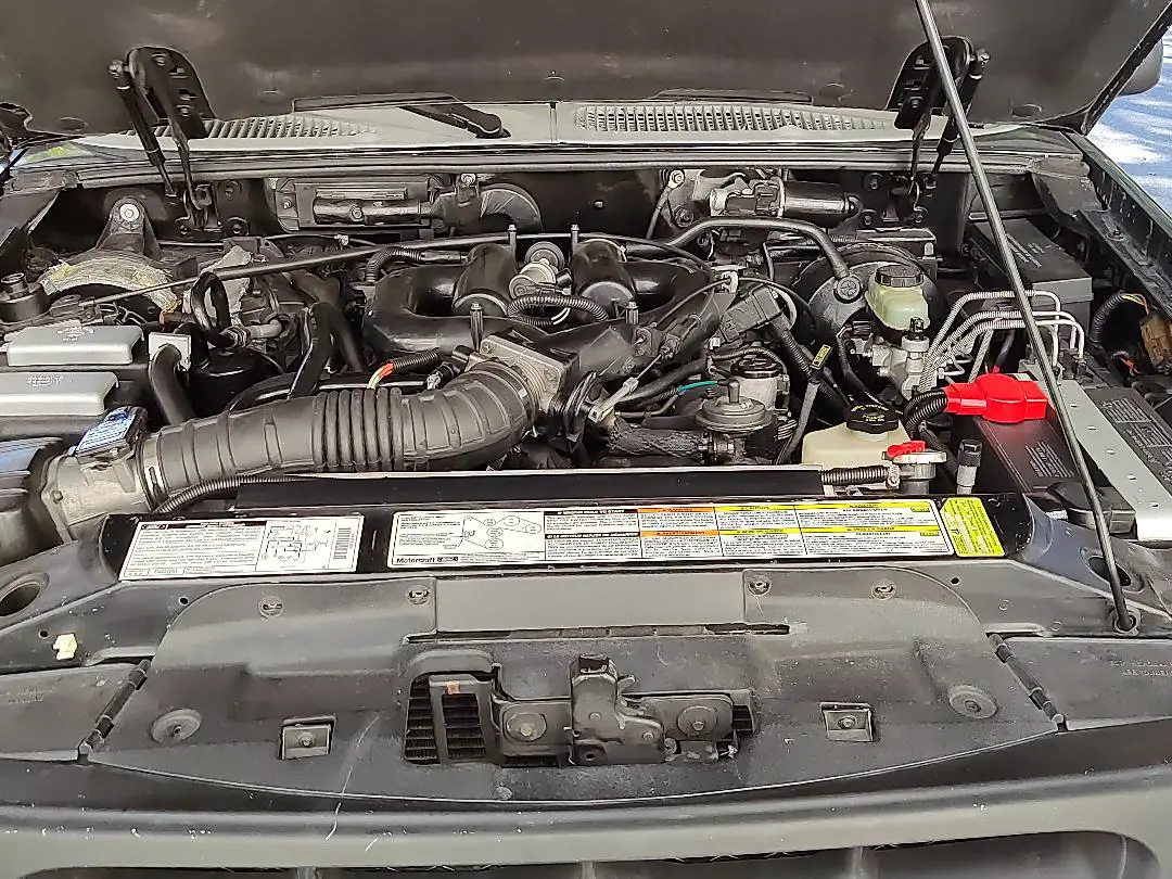

Wanted to share my installation of a 98 Ranger hood prop rod on my 98 sport. Use a 98 Ranger and later hood prop rod and rubber bushing. Dorman hood prop retainer kit # 45396. Key is to drill the holes just big enough to squeeze the bushings in. I modified the plastic shelf/cover to fit the rod in. Hood shuts fine. Dremel tool to slot the plastic piece.
So if you replace the hinges in the back. That hood keeps itself up once open.
