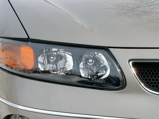

I got 11 mpg in my Explorer after all the mods, K&N FIPK, exhaust, etc. I couldn't take it anymore, $300 a month on gas. Now I get 22 mpg in city driving with the new Bonneville!!!!!!
