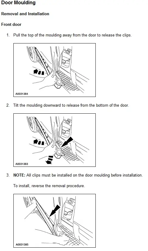

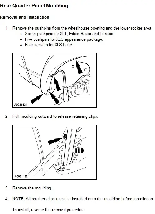

I want to remove all four of the plastic wheel opening moldings/fender flares.
Here you go:
Here you go:
Where are those diagrams from? I'm almost positive my service manual doesn't have those details. I'd love to know.
From my shop manuals in the Body & Paint section.
