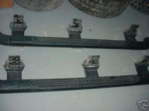

I asked this same question a while back. I have a 96 Sport and bought OEM Running Boards from a salvage yard in Florida. They came with the brackets, but I cannot see where they "just" attach to the rocker panels. I looked underneath and did not think that a mounting to the rocker panel would be sturdy enough. The Ford Body Shop tells me there are additional brackets that come with the factory installed boards that attach to the inside fasciae of the rockers. I believe he said they were welded in there, which means that if I wanted to install these OEM tubular boards, I would need something to mount them to because they do not align to anything whatsover. Who has taken off or installed OEM boards and can shed some light on this topic? I hate to think that I purchased boards that will become backyard torphies. Thanks in advance.:redexp: :redexp:
Look again. There are 3 brackets, each bracket has 3 bolts. There are threaded holes in the rockers. This is plenty strong for step boards, but don't plan on using them as rock sliders

There are 3 brackets on the running board and each bracket has 3 levels of holes but where are these threaded holes in the rockers. My brackets from the running boards do not align to any frame part on the body of the vehicle. Do you have a picture? I am not slow, I have been up under the vehicle so many times looking for an attachment point. What about the driver's side and the gas lines; any hints here?

No pictures, sorry... Assuming your '96 is like our old '98 Sport and my '99 Sport...
Lay on your back under the truck, with your body sticking out perpendicular to the truck and with your head right under the frame rail and look up and out (back towards your feet)
The body has the section of the rocker that extends past the floor board and comes straight down to wrap around the frame. On the vertical section OF THE BODY, NOT THE FRAME there will be 3 sets of holes that align with the brackets for the running boards. The fuel/brake lines run on the frame, and the the running boards attach to the BODY. There may be dirt and crap covering them. It may help to lay the running board on the ground under the truck and then look directly above the mounting brackets to locate the holes.

Look at the this photo, I have since spent some time looking at both the running boards and the truck and my truck does not have any pre-drilled threaded holes. I need to find the hardware, fasteners, that will allow me to drill, tap in the treaded insert, so that I can bolt in the brackets. The brackets can be adjusted to about any position on the running board; insofar as you drill new holes and put in the treaded inserts. Does anyone know where I can find the treaded inserts. I checked hardware stores this weekend and I could find nothing. The insert, when tapped in, must seat somehow so that when you screw in the bolt it does not turn in the hole.
