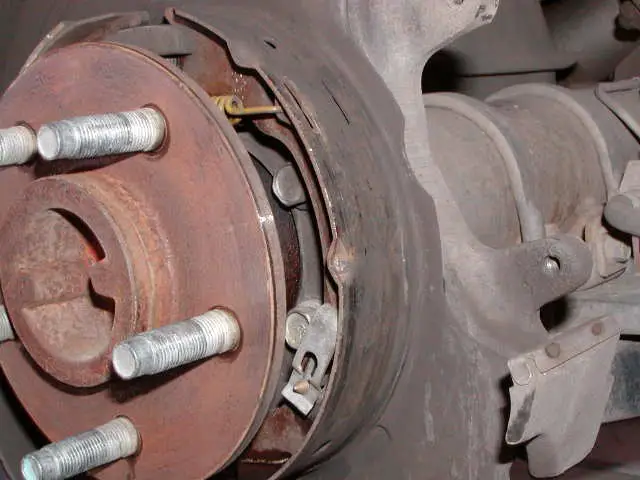

This is what my parking brake shoes looked like at about 95,000 miles on my '97.
It must be great to live in one of those rust free states. My spring clips were so rusted they hardly had any spring left in them
