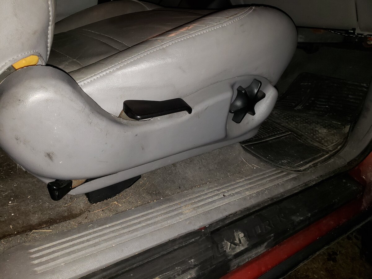

The driver's seat in mine sounds different from yours; I have a power driver's seat with manual recline and lumbar support, handle accessible only from the front seat. As far as I know, leaning it all the way forward doesn't open the slide; I think mine can only be slidden by power controls. Does your driver's seat control look like this?

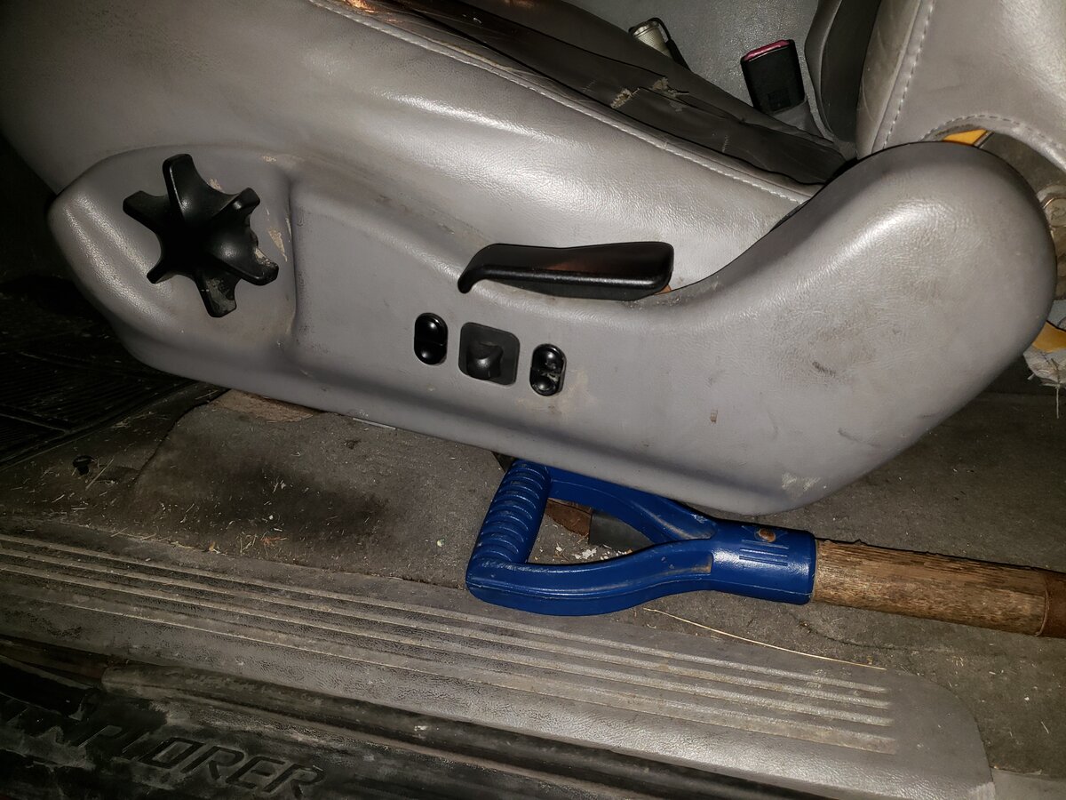

And does your passenger seat look like this? (Notice the black nub on the rear of the passenger seat; that is the kick lever. It is only on my passenger seat, and when you kick it, the recline handle moves.)

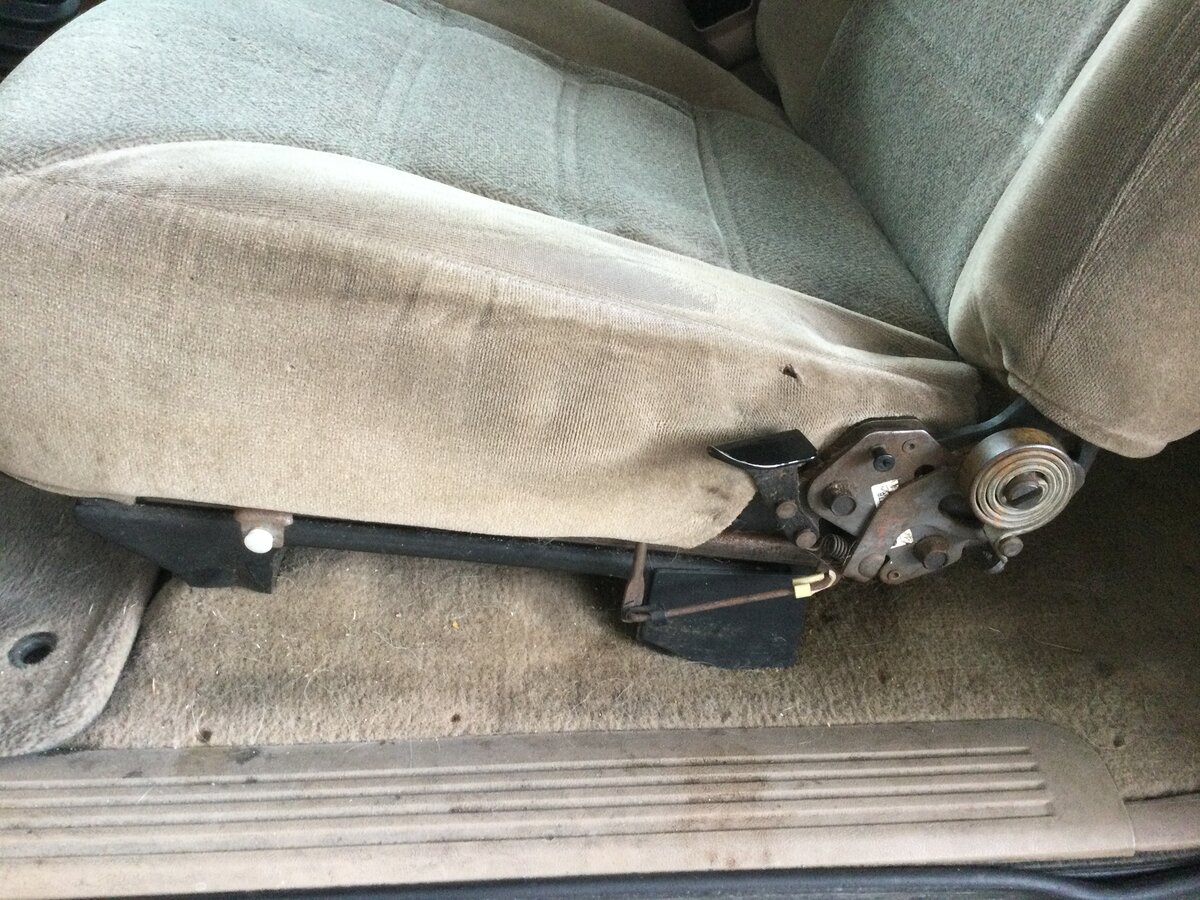

This is what mine looks like

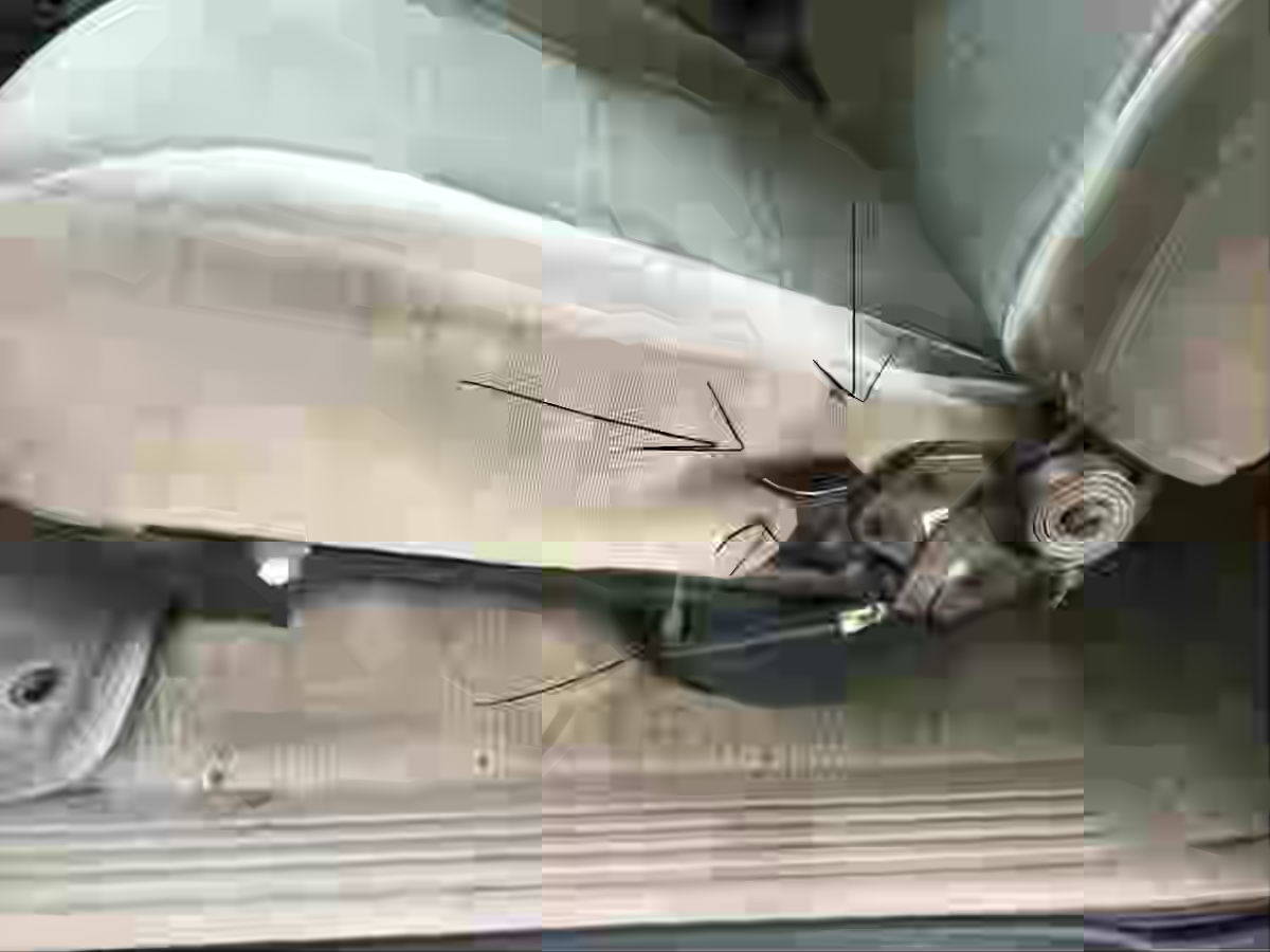

i think its here no?
Yes, that will allow it to recline as well as flip forward. I guess I didn’t explain it very well. I cannot get the seat to sit up as upright as the passenger seat will. Perhaps something is broken.
ohhhhhhh i see. im quite sure in this one the passenger side goes further forward tilt, but id have to check that to know for sure
