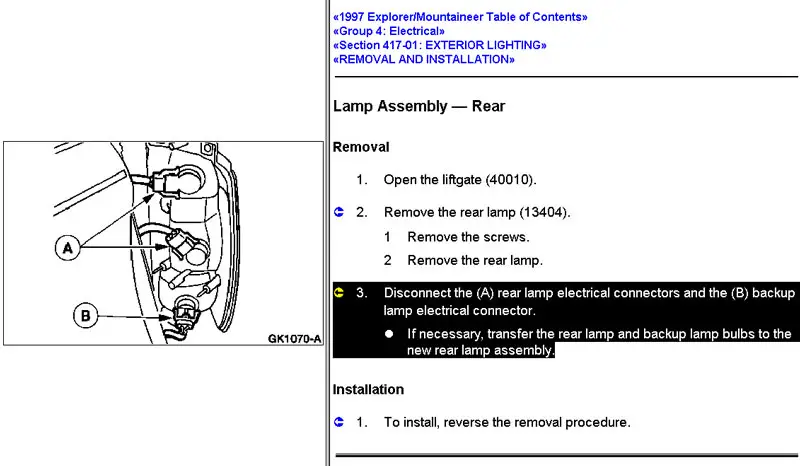

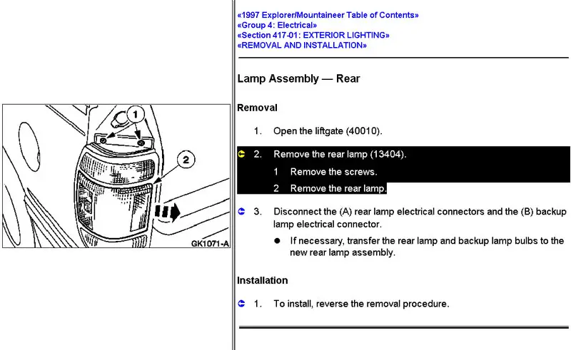

Open the hatch. On the side that you need to replace, remove two screws from the top of the tail light lens assy. The bottom of the lens just pulls out once the two screws are removed. Twist the lamp socket to remove from the lens assy. The bulb is a wedge type; it just pulls out of the socket.
Installation is the reverse of removal ;)

also must mention that when you remove the tail lamp, it will take some force and make a really nasty sound like its breaking but its all good just pull stright out
Thanks a lot guys! Went without a hitch... took like 2 minutes! The bulb was $2CAD. Better than paying $30CAD for a the dealer or anybody else to do it.

a good tip i use is to put some vaseline on those plastic screw thingies that make that terrible sound when you pull the taillamp off. this will make them slide a little better and reduce the chance of breaking off.
