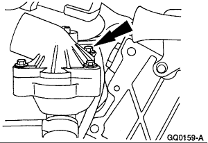

Where is the thermostat on a 99 4.0 SOHC?
Right underneath the upper intake manifold for the SOHC, took me at least an hour to do mine. If you know where the upper radiator hose is, follow it back towards the center of the engine and it's hidden under there.
On front of motor, Has a big hose from the radiator.
