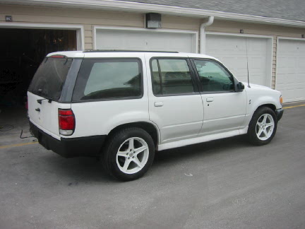

here are teh last couple-
Awesome. I cant wait to see it when its finished.
what was the tin foil used for? Nice that you happened to have a perfect spot to put the camera...
What is the color scheme of the paint going to be?
Edit: you want to send me the plastic hitch cap thingy? :D
I don't like it....I love it. That looks awesome. Especially with the camera and done in such a short period of time.
used tinfoil to get teh initial mold of the corners... lol
again thanks for the compliments and i'm sure it will look much better painted
The LOON rules :D:
I can't wait to see that thing painted. When did you put the lights behind the grille? Looks mean.
a few weeks ago, i'm glad you like em, i know i really do. You gonna come down here for anything this summer. You need to at least make teh trip to Car Craft and come check out all the trucks from our fordtruckworld chaper there (and the 3 from my family and friends club- mine, my bros escape and MikeKnotts explorer)
Just blob a bunch resin (or bondo) there, put on the foil and shape it w/ your hands?
that looks wicked..... its very smooth and flowy... looks almost like it should have come like that from the factory....
thanks Jim- thats the idea so thats awesome
the more i modify and the older i get it seems the more i want it to look like it could be factory. Not sure what that means when i have so many modifications, but i want it all to look like it fits together as if it could be stock just from a way cooler car company than Ford really is. I guess i just want everything modded to the same level now.
on the ends i built them up with like 2-3 coats of glass and got it to span the gap, which was a big droopy mess that looked like it was considering falling on the ground in the next 15 minutes. so i used the tinfoil to hold it in place, and then folded the bottom lip of the tinfoil under to get that rolled curve at the bottom of the pan. When it dried i hit the back with more glass (a ton of it), then did the same on the front to get it as close to smooth as possible. when it was within .5" of smooth i started to use the long strand filler, got it perfectly flat with that, and then used bondo "ultimate" to fill the pinholes and stuff. really made it very strong and avoided using the lighter crappier fillers as much as possible.
