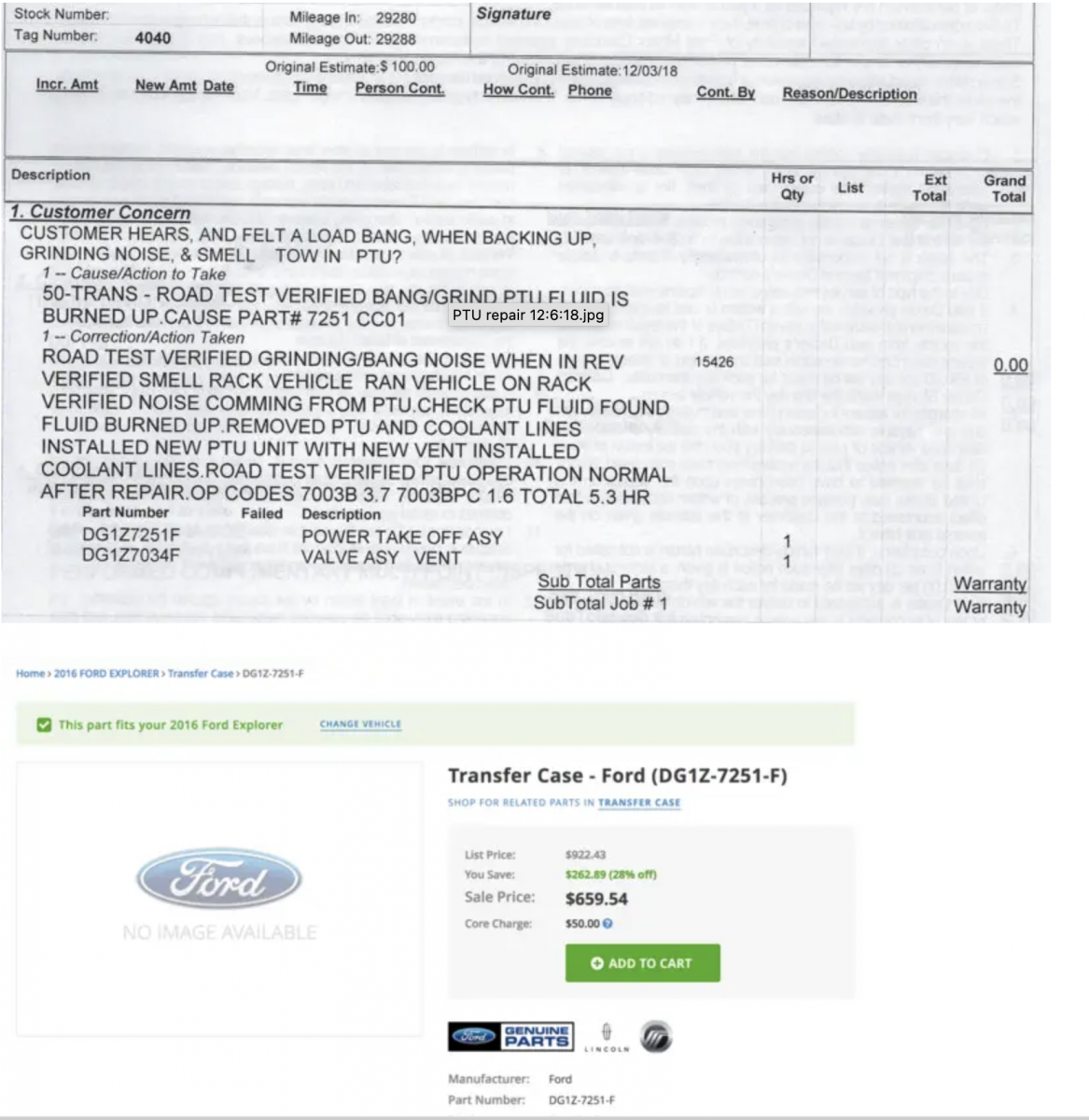

The original question is how long should it take to replace a PTU. According to my service receipt Ford allowed 5.3 hours of labor for the entire job on my 2016 Explorer Platinum with 29280 miles on it. (see below)
Why your dealership is taking longer is the question you need to discuss with them.

Thanks this was the answer I was looking for. I also had the same exact issue so I am thinking my bad ptu may have cooked the transmission.

You're welcome. This 'cooked transmission' situation also crossed my mind when my PTU failed so I had them check the Trans fluid, they said it was okay. However, not always believing everything I hear at Dealerships I paid for a fluid replacement on my transmission. That was about 18,000 miles ago and so far the ExPlat is running nominal with only 47,000 miles on it, as anyone might expect.
