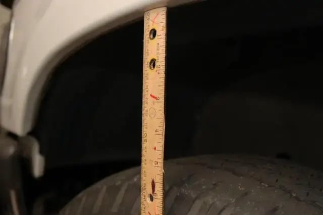

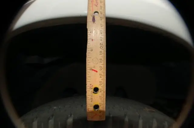

This is the height that it's at right now:

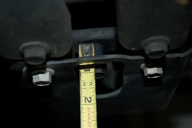

This is the passengers torsion bolt:
And this is the Driver's side torsion bolt:
Both are about and pretty close to 3/4
And it was so hard trying to get those pictures haha. Sorry they're not too great though.

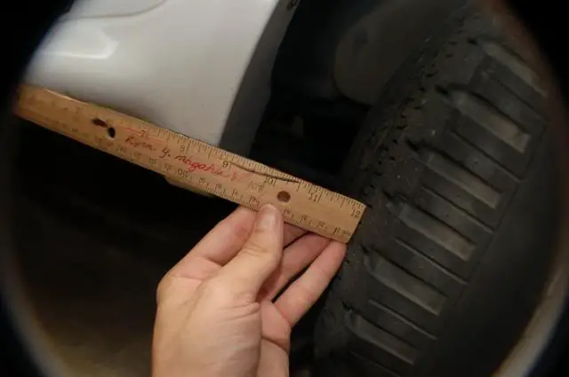

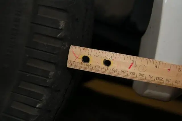

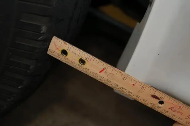

And also I figured I'd just go ahead an add these in just to give you an idea of if I can fit 32's pretty well or not:
This is the passenger side clearance:
Driver's side:

You might get a 1/4" - 1/2" if you are lucky. You can buy longer bolts. There is a thread that gives the thread size but I don't know which one.
What torsion bars do you have? It says on the driver side door if you didn't already know this.
get the tires, if they rub crank some more or trim
Honestly i wouldnt go up much higher if i were you. i went up way to high a few months ago and lost all downward travel in my suspension. It will ride like crap and start to wear parts out very very fast.

Jimbo, I'm all up for trimming as long as I don't have to cut any metal. Metal that shows anyway. And they're going on a 15x8 rim so that should make thing's harder.

You will need an M12x1.75 Grade 10.9 Most hardware stores dont carry that high of a grade in metric sizes. (They usually go up to 9.8)
Hokie is correct. It's easier to just order them online than try rooting around to find a shop in your area that carries them.
