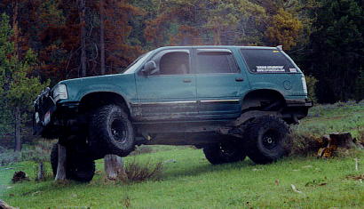

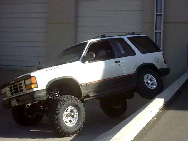

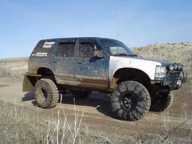

Here is a couple of pics of my 93 sport on 35's. I am running a custom SAS with 4inch lift coils and clear the tires fine. I would say don't waste your money on a lift. You should buy a SAS kit from me and do it right the first time :D I do not run any body lift but I did move the axle forward about 3inches which let me lower my lift from 5.5" to 4". I know that with the superlift kit it is possible to run 35's but you will have to trim your fender some or just beat it in with a hammer ;) which ever works better for you....LOL

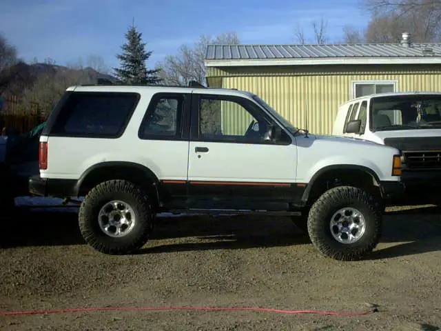

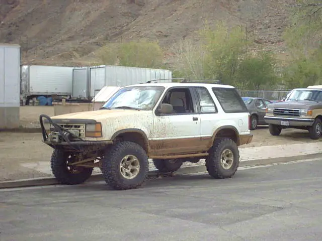

Yeah lots of lift is the name of the game. I'm runnin 5.5" suspension and a 3" body lift. I cleared 36s with stock fenders on and had room for 38s with fiberglass. I don't recommend you goin to 38s, I just did for fun while at the shop. And no pics of the 38s. :D But heres mine with 35s with stock fender and 36s with fiberglass.
