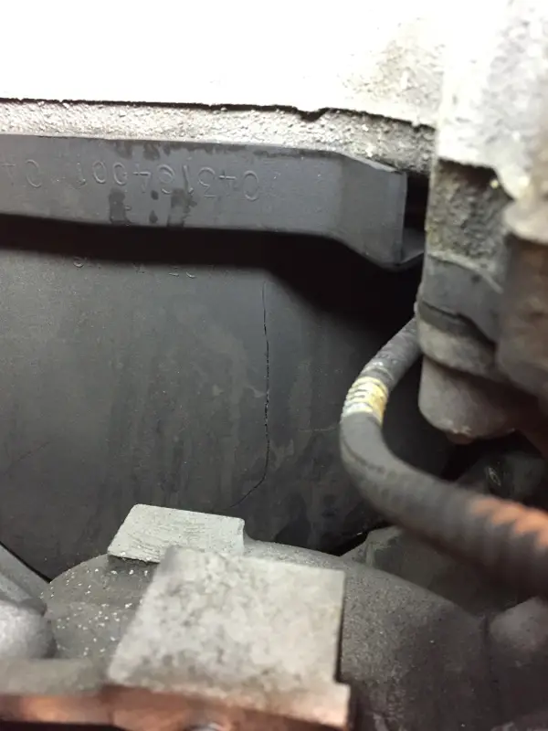

What does the plastic part under the intake do? Mine has a crack in the front, maybe more that I don't see. As the OP's pix showed, the underside piece falls apart. Will it create a vacuum leak?
Mines not leaking any antifreeze, but at times, the PCM is having to add fuel. Just found this when replacing the alternator, again.
When I replaced my intake manifold, a big plastic shield that surrounds the bottom of the old manifold came off -- in easy to break off pieces. I couldn't figure out what it was or where to buy a new one, so I called Dorman since I was using their new part. They said it is a noise reducer/insulator. He also said to throw it away. It won't hurt a thing.
Thanks! That's what I'd read in the 4.0 post, but wanted to verify. I touched the lip on mine and it just fell off. Was kind of hoping it had something to do with my positive fuel trim, oh well.
