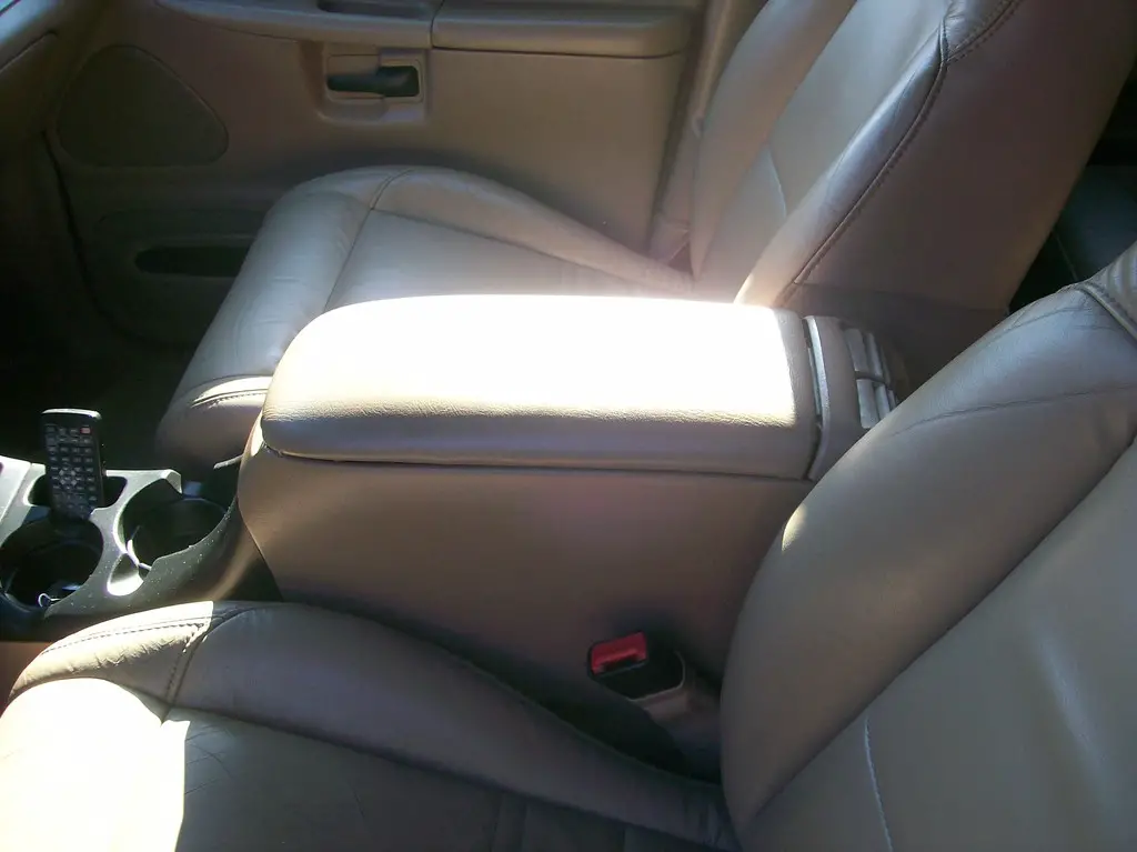

The secret to not having wrinkles is to stretch the vinyl tight over the lid. You can't do that very well if you use adhesive. Using staples you do run the risk of cracking the plastic lid, but that's the way Ford originally did it. I'll be repairing my 4th console lid in the next couple of days. The first one I did came out great, the next 2 lids had cracks before I even installed the covers, so they came out only fair. The one on my ST was so badly broken I had to replace it with a recovered one from eBay. The lid I'll be doing soon is in pretty good shape, so I'm hoping it comes out good. I'll be using 1/2 stables.
Here's a pic of the 1st one I did using a cover from Zealous Interiors.

I finished recovering my 4th console lid the other day with a Zealous Interiors cover. It came out almost as good as the one pictured in my last post to this thread (see post #5 ). I'd rate it a 9 out of 10. I used a heavy duty hand-held stapler, which worked okay, but not as good as my old HF pneumatic stapler (which I can't find staples for anymore). Some of the hand-held staplers staples didn't go in all the way, but they held the cover tight until I got the bottom of the lid back on.
