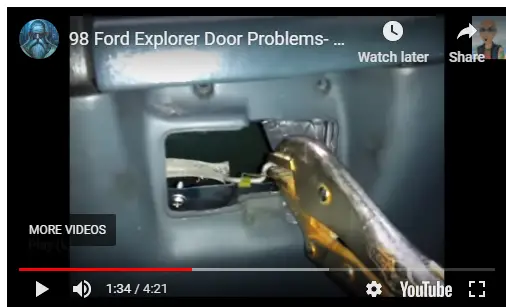

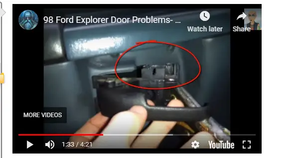

Not removing the handle. Only need to remove the plastic trim around the interior door handle.
Be careful and use a wide tipped flat blade screw driver to remove the handle's plastic trim bezel..
He defs removes the handle, sorry i wasnt that clear
Sorry. Need to remove the plastic trim bezel around the interior door handle before you can access the door handle screws.
Be careful and use a wide tipped flat blade screw driver to remove the plastic trim bezel. A stiff bladed putty knife also works,.
