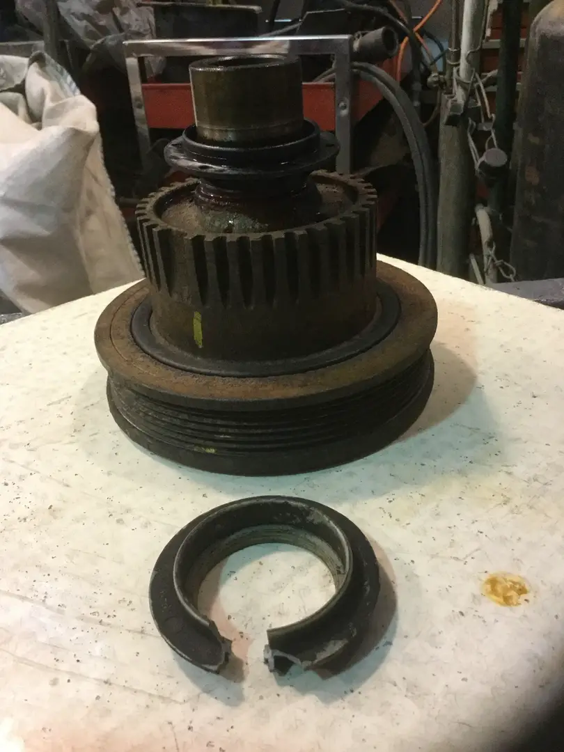

Anybody know the procedure to do it before I break the new one?
I assume your talking about the plastic seal protector ring. If so heat it up with a heat gun or put it in the microwave for a few seconds.
It sounds like the same puppy I had thought about warming it up but have to admit it would have been my very last choice.
Thank you.
I have to thank you again,with a bit of heat it snapped into place with a resounding click.
