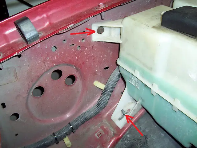

I'm trying to remove my coolant reservoir on my V6 2004 Ford Explorer. However the Air Filter housing is blocking one of the bolts, and I have no idea how to move the lower bottom of the air filter so I can access the bolt.
Please help!

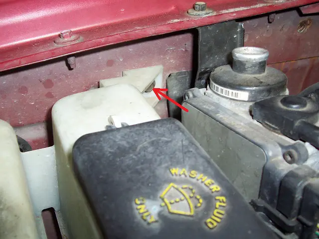

On my 2000 Sport with the SOHC V6 there are two nuts and two bolts that retain the coolant/washer reservoir assembly. You probably have to remove the air filter enclosure to remove the lower, forward nut.
You probably have to remove the cruise control servo mounting bracket to remove the lower, aft nut that is directly below the servo.
How in the H does the lower part of the air filter housing come out?? oy!
Hallelujah i got it out!!
