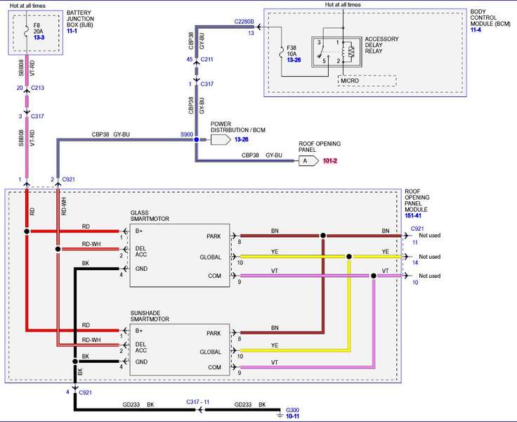

I used the sunroof switches when I had my XLT. I don't recall which wire I tapped however, I used my multimeter to find the accessory one. The ground was black (I believe the thickest wire in the harness)
Here are some of the wiring for the overhead console and the mirror itself
thank you for this!
where do you get the diagrams from? Is this a source I can pay to download? Or does it require a subscription?
