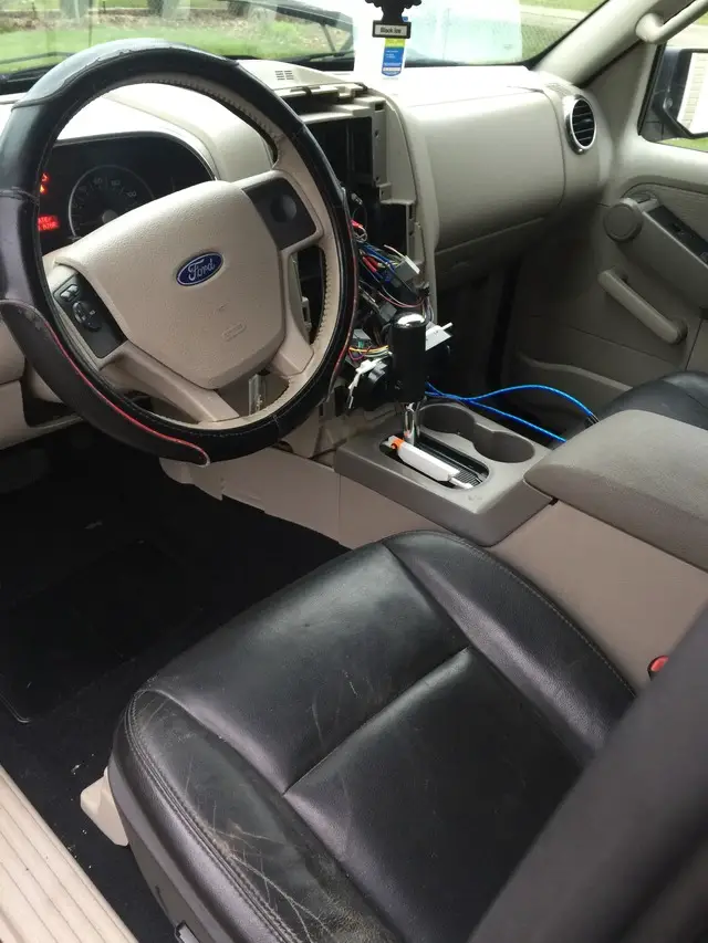

What I did was laid it out on the deck in the sun for a few hours, but was impatient and wanted to get it done. I had already gutted my interior again, seats out, most of the panels out (I was also swapping seats, and installing/running wiring for a 4 channel amp) and took my carpet out.

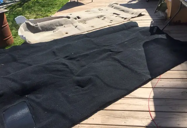

I put my carpet on top of the new carpet, and as you'll see in the pictures, its longer, wider, and has no holes cut.
When it was sitting on my deck, it was pretty flat. The transmission tunnel was distinguishable, but thats about it. Try to get it to conform as close to your stock carpet as you can when its sitting on it so you don't mis-cut or cut stuff crooked.

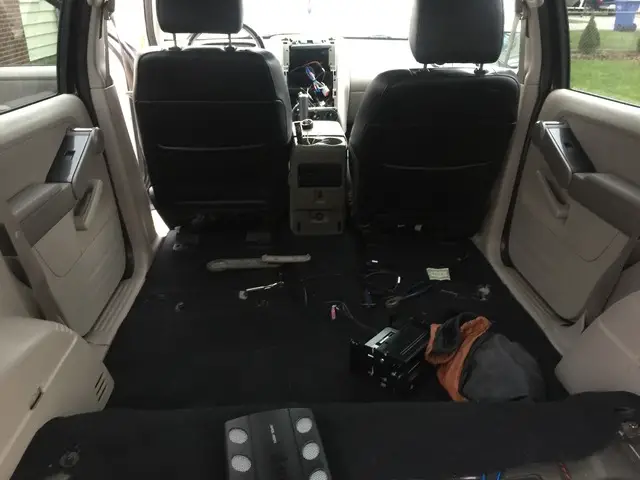

I test fit it, looking at what needed to be trimmed, which was ALOT in the front corners, around the trans tunnel, and the back where it tucks under the interior trim.
I opted to cut it while it was still in there, so I could take off little by little. This may have saved some time, but it was a headache.

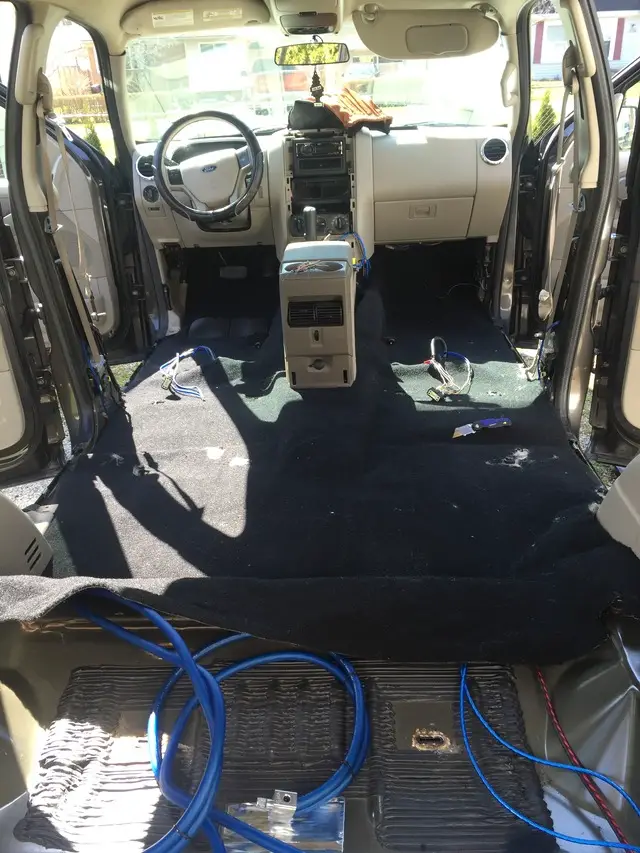

Once I was done, and started putting on trim panels, it looked so much better. It does not fit perfect by any means, there are areas that aren't molded as good as they should be, and some of the molds are a bit off, but that could have been me adjusting it too far one way or another.
