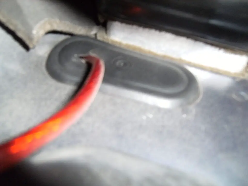

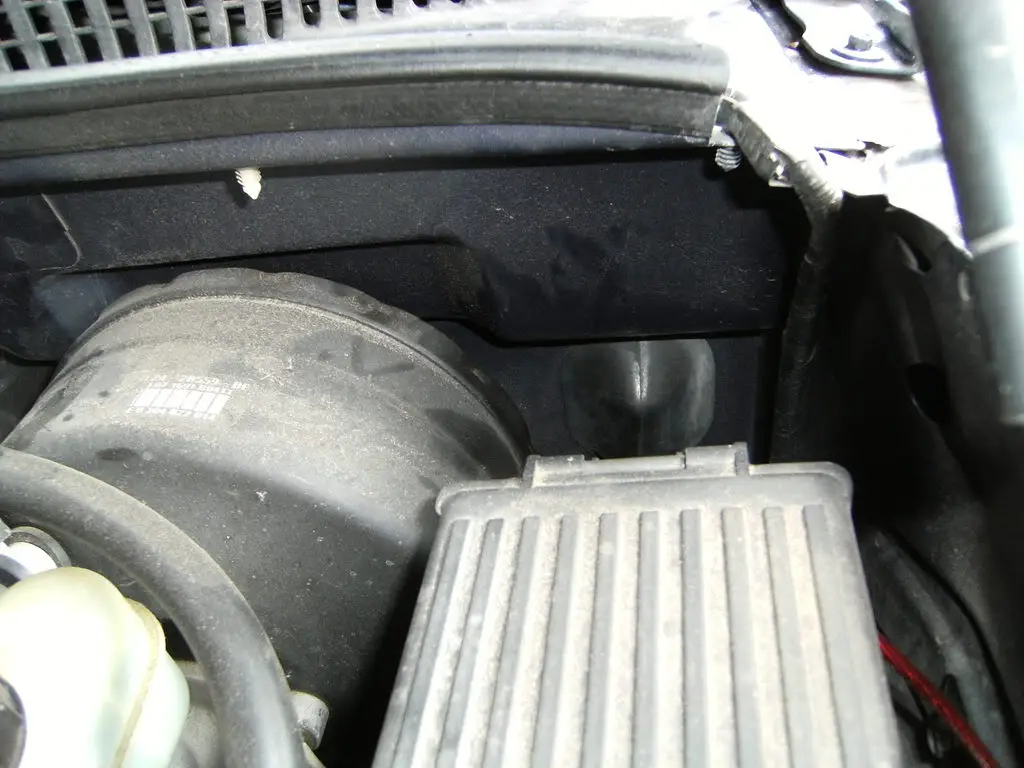

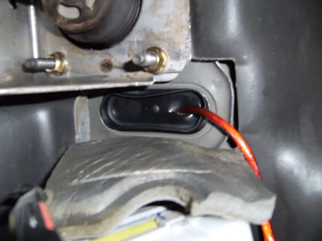

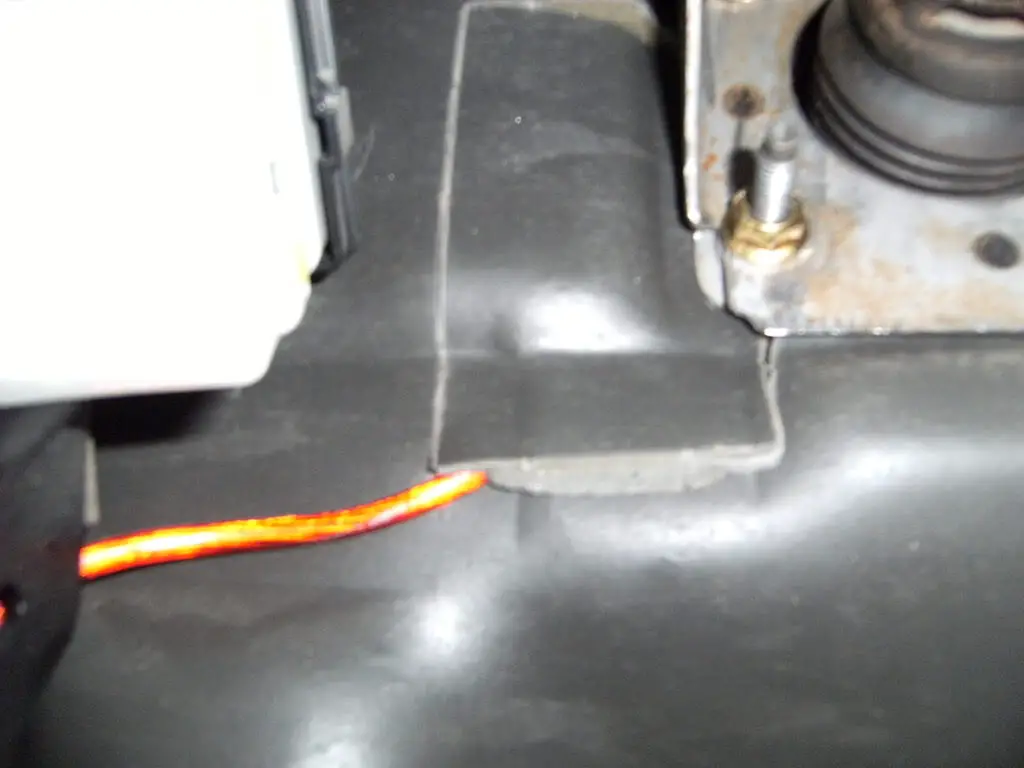

Not sure if there was a change but this is on my 02:
Behind this:
There's a rubber grommet that inside goes:
You lift that flap:
and poke a hole in the rubber to pull your wires:
