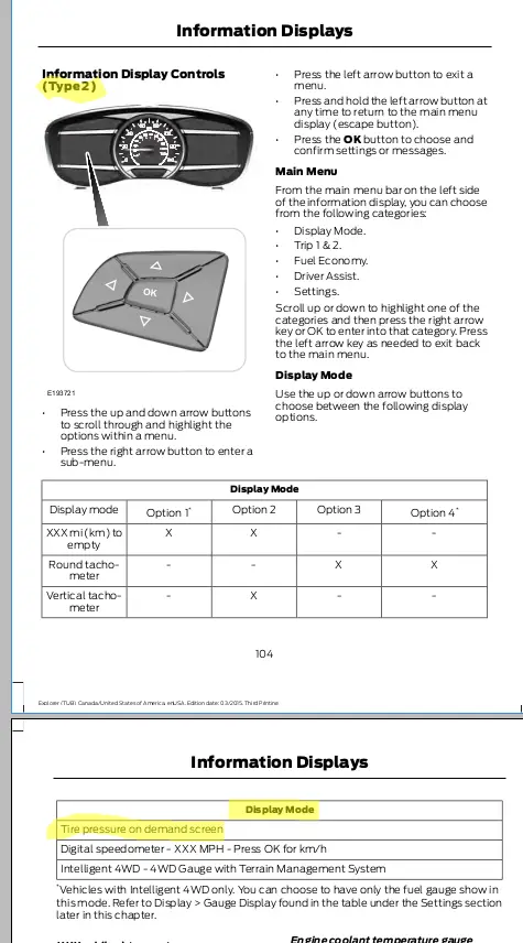

I saw it once. All four tire pressures were displayed in the Information Display on the dash. Now I can't access it.
In the Owner's Manual, I read the Information Displays section completely and it says should be available (I have Type 2) via Display Mode > Tire pressure on demand but from Display Mode there is no Tire pressure on demand option.
And yet, I saw it one time so it must be there. Can anyone tell me how very specifically how to access it? Btw I do have the tire sensors installed. Thanks.

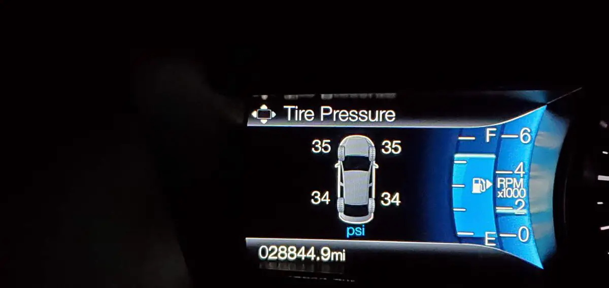

Just scroll Up or Down on the Left steering wheel controls till Tire Pressure readings are displayed. It'll be mixed in with the digital speedometer, rpms and fuel tank as well as tachometer.
Thanks but by "scroll" do you mean the up and down arrows? And then, don't the arrows give you specific categories like: "Display", "Settings", "Driver Assist" and then subcategories within each? Are you saying just clicking on the up and down arrows will eventually lead to the Tire Pressure display?
Got to be in Display Mode, then yes, scroll Up or Down till Tire Pressure is displayed.
Okay. I looked in Display Mode before, and the up and down arrows gave two options neither of which were Tire Pressure, but I did not push the arrows continuously. So I'll give it a try. Thanks very much.
